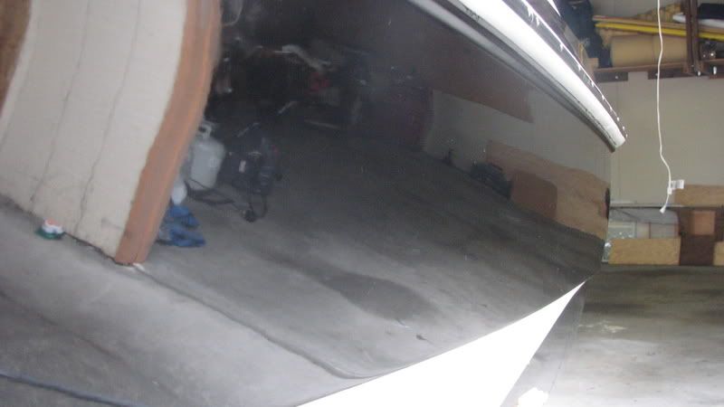

Here is a example of using a marine self leveliing paint, all that is needed is a few 4.00 roller's sand paper and a litle time and patience.
http://forums.iboats.com/showthread.php?t=201765
