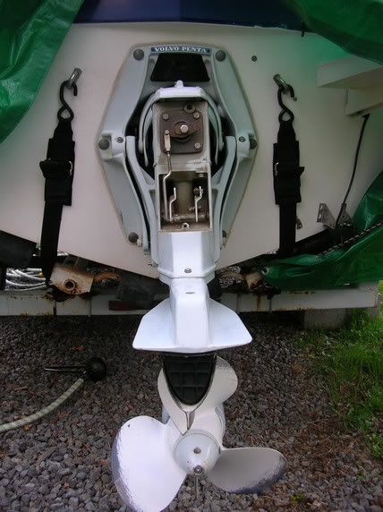

Didn't see any on EBay but I have only been looking for a few weeks.<br /><br />The other problem is I assume this is a 270 outdrive, since VP webpage lists one paired with a AQ125B but no info on the AQ125A engine. Can I insert a picture of it on this forum, and maybe someone can help with identification? There is a long number on the drive unit itself on a plate #27125581D but I cannot figure that one out.

The 280 cover will also fit.<br /><br />A pic will help. Download your pic to a pic hosting site such as photobucket.com.<br /><br />Click on "full reply form" > "image". Insert the URL of the pic into the image field. Done.<br /><br />Aldo

<br /><br />this is a pic of the drive.<br /><br />Joe

That's a 270 ( in damn good condition!)<br /><br />Aldo

thanks Aldo for the identification help, and I did find a cover on EBay today, now if I am the successful bidder...<br /><br />the drive is in good shape except for the tilt mechanism being messed up- the pic shows it in full tilt mode, and I would guess it should be more than that. any ideas?<br /><br />also there is a small water leak coming from beneath the drive leaking out over the top of the zinc on the transom when I run it on the garden hose. I am thinking it may be a leaky water exhaust hose on the inside? any ideas on that?<br /><br />Joe
