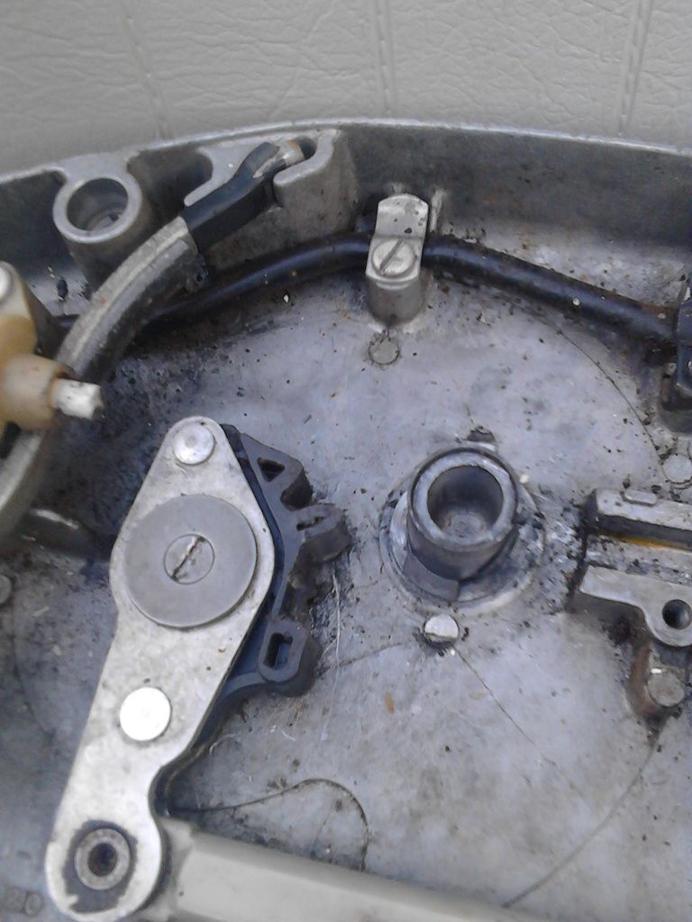

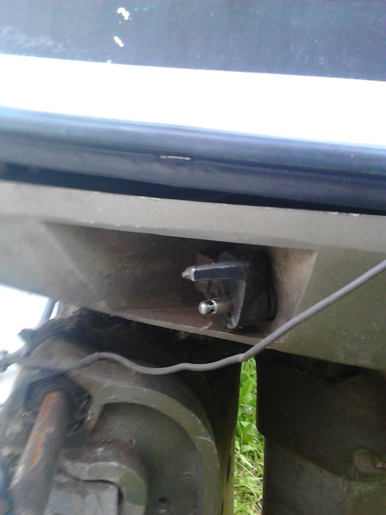

I need some help finding parts numbers. Looked at the exploded diagams and still can't figure it out. Engine is a 1975 135 Johnson first pic\part is where the fuel line connects to the engine, it takes a fancy plug
Second is a plastic guide that holds the throttle thing on the end of the cable. It's supposed to have two ribs sticking out but one is broke. All help is greatly appreciated.

The second photo is the fuel connector and is shown on the motor cover diagram. The "fancy plug" that connects to it is shown on the fuel tank diagram
Cant help with the throttle cable part. Is this in the remote control ?

The plug for the fuel line can be bought at any boat shop today.------The broken part in the control box may not be available new any more.----Pehaps you can make that with a piece of 1/4" aluminum plate.

The control box part you are looking for may be part number 173542. It's no longer stocked in the prime factory warehouses. They do show stock on it at their "vintage" warehouse. The fuel hose connector part number 173247 has been superceded to current part # 775640. See any Evinrude dealer for these items. My personal preference has been to eliminate the plug-in fuel connection on the lower cowl. It is just another place where you could get a fuel/air leak and it's a point of fuel restriction. I removed the black connector (in your picture) from the lower cowl, then threaded the bare end of the fuel hose into the hole, bend it easily around at up to the fuel hose barb on the side of the fuel pump. It's not removable that way, but it's a much more reliable setup.
