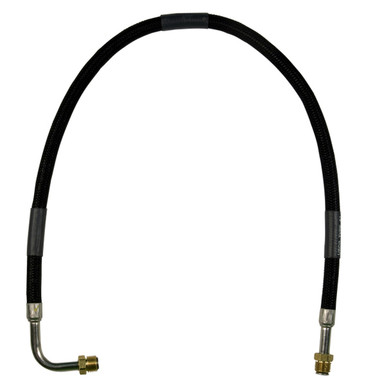

OK got a question about using a Sierra A1 flex fuel line (this is if I wind up converting from my Quadrajet to an Edelbrock in the future), this Sierra line has brass fittings that appear to be 5/8ths" but the threads in the fuel pump are 1/2". At the carb end the Sierra threads right into the fuel inlet on the Edelbrock so no problem there. I'm thinking that I need an adapter with female 5/8ths" to male 1/2" for this, correct? Brass?

Ayuh,....... Have ya got a link, or picture of that fuel line,..??
Sounds like nothing I've run across,...

they seem to use this on their carbed turn key engines...
the right angle end threads right into the Edelbrock fuel inlet, the fitting on the end for the pump is the same size but the outlet for the pump is smaller, so I think I need a fitting with a larger female end (for the larger Sierra hose fitting) and a smaller male end (that fits into the fuel pump outlet hole). Hope that makes sense.
51,383
The 5/8" threads are for 3/8" inverted flare tube nuts
The ~1/2" is 1/4 NPT
They make adapters to go from the 3/8 inverted flare to NPT and back. See your local NAPA

I’ve always understood that flex line from the pump to the carburetor has to be pipe on a marine situation.
Lou C
Nov 10, 2002
13,422
I think the flex line that Sierra makes meets the requirement because the ends are permanently secured with metal fittings on each end. Michigan Motorz uses them on their turn key engines…..
Lou C
Nov 10, 2002
13,422
I would use that Sierra fuel hose but not barbed fuel hose fittings w/clamps & rubber hose….
