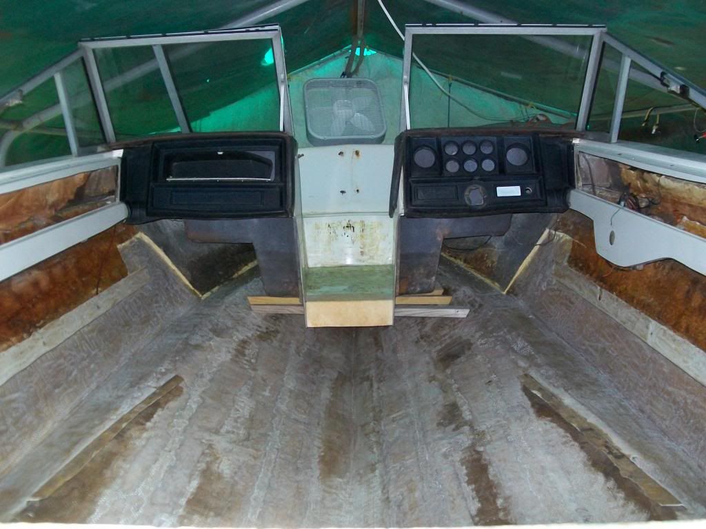

I bought an 87 sea ray s21 260. Found out after having it about a month that the floor was really bad. Started with just a little weak spot then turned into a lot more spots that just got bigger. Tore the deck off and found the stringers were pretty much gone. Started taking everything apart and ran into a problem. I have the deck, stringers and foam taken out from the transom all the way to the dash. Can't figure out how to get past that. Also if I can get any help with how much fiberglass cloth, resin and foam I'm going to need that would be helpful.

IMG_6333-2_zpsc2513c5e.jpg IMG_6333-2_zpsc2513c5e.jpg I bought the boat for me and my two boys who are young. I dont mind doing the work and it will help me teach my boys a few things. I thought i posted a pic but ill repost.

As previously stated, if you search the forum you'll find a lot of similar rebuilds to yours. You'll also see where it may or may not be necessary for you to cut away the floor/deck area show in your pics to gain access to the bow section of the boat and to remove the foam and stingers.

Thanks for the advise. I'd rather not have to pull the cap. I'll try to work around it and see how that goes. It's to cold to do any glass work but I want to get everything ready to go for when it warms up. Buying all the material to have ready next week. The original owner redid the deck but didn't glass anything in and didn't put the outside stringers in. You can see where the glue is but no stringer is there on either side. So going to have to figure out a stringer diagram if anyone knows where I can get one at. It's an 87 sea ray s-21 260 with the 5.7

SD, IMHO As long as you can get to all of the areas that need to be addressed and do the work, needing to be done, I see no reason to de-capitate any boat during the restoration. There are Soooo many benefits of NOT doing it. For most I/O boats the cap is not removed but do to the splash well configuration on Outboard boats it is necessary to, at the very least, cut away the splashwell portion of the cap to get to the transom and or remove the entire top cap. It's almost impossible to keep the hulls shape during the restoration process no matter what you do to prevent it from becoming mis-shapen it will happen and I've seen some pretty bad problems occur especially when the person didn't take adequate precautions. I'd always recommend leaving it on whenever possible. But Hey, Everybody KNOWS I'm just an Old Dumb Okie, so any advice from me should always be taken with a grain of Salt!!!!:D;)
It's fairly easy to fab a stringer....you run a mason string from bow to stern at the bottom height of the deck and above/along the stringer location....mark the line with a sharpie marker every 12"...now measure down at a 90 degree angle to the hull at each mark...record those measurements...transfer those marks to your new plywood stringer material...connect the marks and you will have a template for the stringer... I like to make the stringer about an inch or so taller so if I need to trim or shape it . Once it's fitted you can trim off the excess from the straight edge to get to your deck height.. hope that helps
