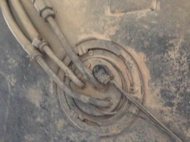

Thanks have a Napa right down the street here I did get 15 gallons out tonight will clean the tank off in the a.m. and get the rest of the fuel out tomorrow. The connection on top of tank with the wires does it just pop off or twist off?
MRS
Jul 10, 2005
2,580

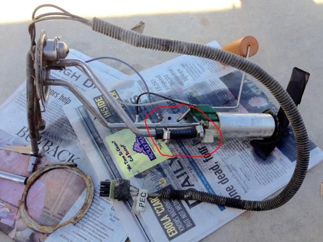

Ok can pull the top off with out dropping tank lots of room under there here is what I found the hose here in the red was gone. Motor would pop a little when first starting but not now and with only 20 gallons in it would not run I drained all gas and added 20 gallons and runs great.
