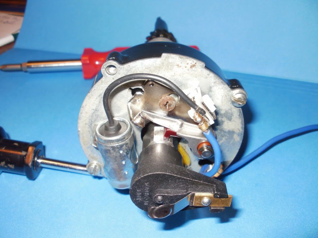

This distributor is from an inline 165 but would be very similar.

I have installed this type on some engines and never had a problem with enough spring tension to hold the wires. I guess like everything else things are being made cheaper and quality control is gone by the wayside in many manufacturers.
