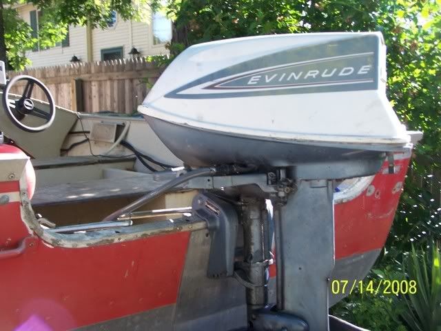

Just acquired this 1964 Rude 18hp and have some questions.
1st what Ive found so far. Overall the motor was dirty and oily though mostly complete. A few small pcs. missing. After i got it home I checked fuel, compression, spark and looked over the lower unit and shift linkage.
Compression on both cyl. was 85#, Spark from both coils and the carb had some of the linkage disconnected. Condition of the water pump is unknown but that will be replaced regardeless. Prop is in VGC. The gears do not appear to be shifting correctly. Has a problem finding Forward. The spring for the detent is missing.
After rebuilding the carb and putting it in some water and connection the gas I was able to get it started. Found that the throttle and advance are out of sync and that the plastic pin connecting the tiller gear to the linkage is broken.
I believe I shouldn't have a problem finding the small parts I need. I found a website that has parts breakdowns but only goes back as far as 1968.
1st question. Now that it has actually ran and has been lubricated will the compression still come up? Will Seafoam help?
2nd, I did not see it Peeing, does the 64 18hp have a telltale and were should I look for water discharge? Only ran it a minute or two and when I shut it off it was hot but I could still hold my hand on the head.
3rd, Lower unit shift problem. What am I looking at for problems. The shift linkage in the lower unit is working and doesn't look as if it's been worked on. Has carbon build-up on it.
4th, It has a fuel pump on it but neither me or NAPA could find a number for it or a rebuild kit. Any ideas?
