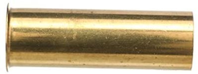

my drain hole is 2in above keel I just decided I'm gonna pour resin into a puddle into the keel to set a transducer for depth/fish finder then use 3in copper coated with PB

That's great, but make a hole larger to eliminate the possible wood to eliminate the wood contacting water. I used pex and a little 3m 5200 on the outside, whether I needed to or not.
