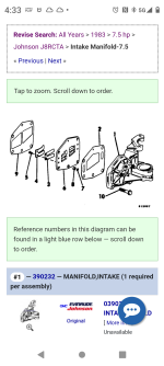

Here's a parts drop.....

Crosbyman
Nov 5, 2006
5,679
behind the carb is a plate behind that plate are reeds ... intake manifold
no fuel sucked in could be CC vacum losssomewhere ( but check the delicate reeds on the failing half of the engine cc.
