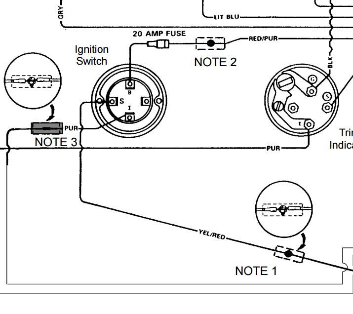

The red/purple wire goes from your engine compartment through the main connector then up to your ignition switch. Take your volt meter and see if you have power to the "B" connection on your switch. If not, you are losing power somewhere in between. Usually it is either a fuse or a bad connection at the main engine harness connector.

The good news is there are very few possible explanations. You will have to start tracking it down. See the pic below - if you do not have power at the "B" position of your switch, then you have a break somewhere. As the pic below shows, you have a fuse inline somewhere. You will need to track it down.
You have already had the connector taken off - one thing you can do is get a length of wire and use your ohm meter to see if you have continuity for the entire length of the wire.

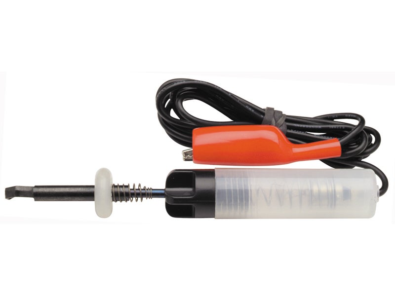

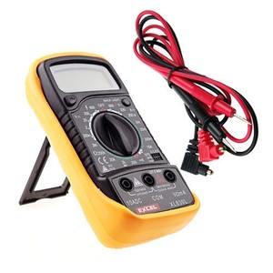

Tracking down wiring issues is no fun... but it is imperative to have a few basic tools to do so. These two tools are pretty much essential:

Fixed the issue... It was the inline fuse under the dash that was blown... Replaced it with a 30a (causes that's what was in there) and motor turned over and started like nothing was ever wrong
