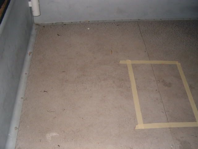

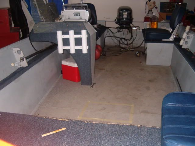

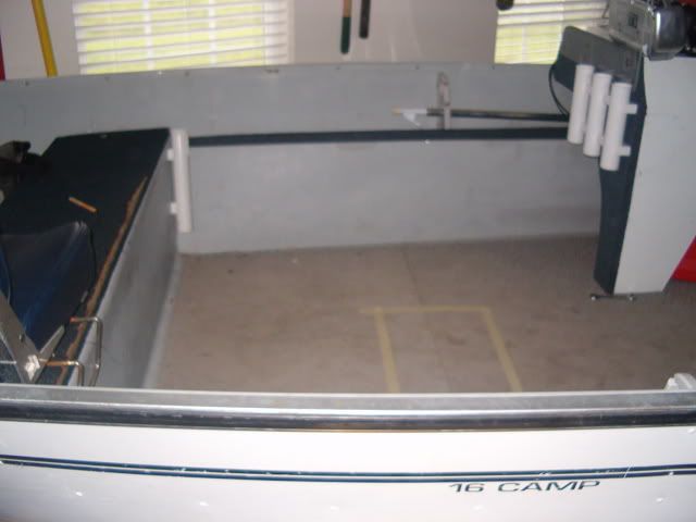

1994 Aluminum Starcraft that has several soft spots, I taped one off to show how large it is. Also, screws to secure seats and componants to the floor won't tighten. I think I need to relace the entire floor.
I have read some posts about using AB 1/2" plywood and putting fiberglass on both sides to help protect it. I have all the tools (jigsaw, sabersaw, tablesaw, etc)
My first question is do I just cut the old floor out?
If you notice the lip along the floor, how am I going to get the new floor under that lip?
Thanks in advance

It's just my opinion but I would just plan on doing it right. Do the whole floor with marine plywood, stainless screws and new carpet (or whatever you feel would be a good floor). Getting the plywood under the lip should not be a challange as long as you use the same thickness of replacement wood.
Just a suggestion - if you remove the floor completely it will give you the opportunity to replace the foam and insure no future leaks. Obviously water got trapped in there and we should be able to guide you through a cure for that too.

just did a Bluefin Spectrum, when you drill out the rivets around the outer edges the side panels will flex enough for you to get the floor in under them. i used stainless screws to reattach.
