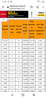

Ayuh,..... It's probably 1/2" pipe,..... very common,......
The other possibility is 3/4" pipe,....
The Od is 'bout 1/4" larger than the actual size,......
