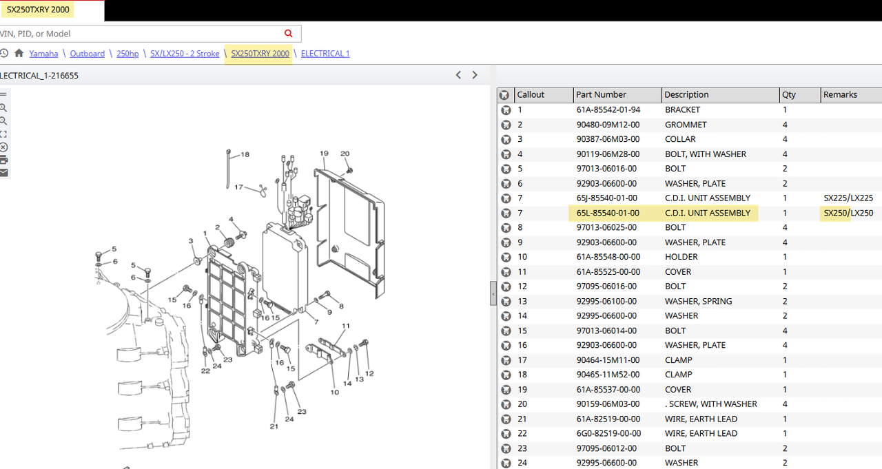

The Y in the model identity SX250TXRY indicates it is a 2000 model year motor.
The parts catalog shows that the SX250TXRY was delivered with a 65L-85540-01-00 CDI.
The -00-00 and the -01-00 CDI's have been superceded by the -02-00 CDI.
Either the 00-00, the 01-00 or the -02-00 CDI's will work on your motor.
The CDI's are made by Mitsubishi for Yamaha. The F 8 T-33771 - 8728 numbers are Mitsubishi numbers.
Let the parts catalog be your friend.
boscoe99
Aug 22, 2013
2,193
You are welcome.
I should have noted the dash numbers are not related to the calendar years. All part numbers start out as -00-XX. If and only if they are updated do they change to -01-XX and so on and so forth.
The last two characters/digits in the dash number is a color code/finish code, if and when it is applicable.
