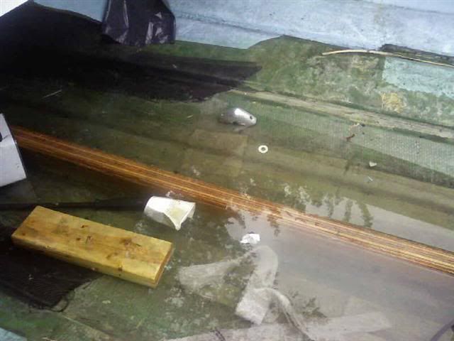

i've been stalled out on my rebuild, and brought her home so icould build at night after being with the family. Brought it home wednesday, and had a storm over night which left the keel i just placed in under water. I had to drill out a small hole in the transom to drain, but didn't coat or put a proper plug in. The keel is a 3 piece laminate of 3/4 marine ply, and the transom a 2 ply. It has been under water all day, with only a single coat ofglass resin on it . Is all lost???? Or can i let it air dry and get to it again. I have to finish the keel by encapsulating with glass still, or is this going to affect the keel and transom enough to doom the project. Thanks all, hoping for the best

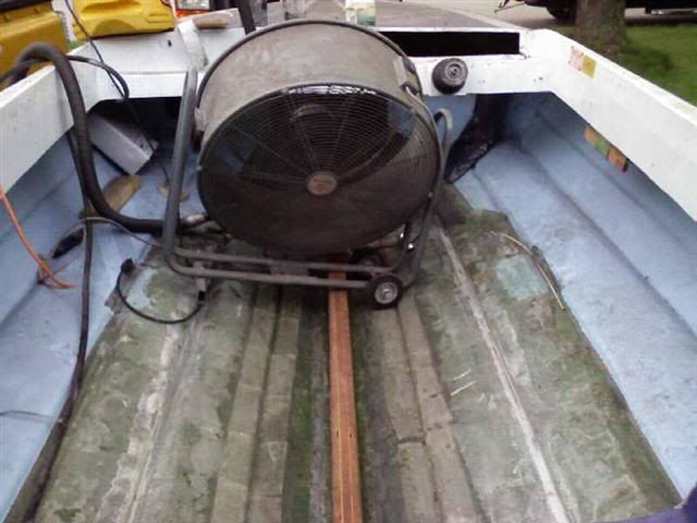

Here is what i got into the vessel tonight after shopvacing. Very slight puff of air coming out the transom hole. Luckily, when i drilled it out to drain , I drilled under size by a 1/4 inch or so . My hope is that after a few days drying time covered, well now in tarp, that i'll drill to the full size and get rid of any moist wood.Thoughts?
Thx again

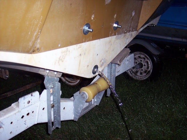

Been there, done that :D Flush that hole with a healthy dose of acetone or xylene to help draw the water out/dry it. That's what I did, and then after it was dry, promptly installed the garboard drain and sealed it up with 4200 and some fiberglass.
If the glass gets milky white on top after it dries out and you aren't doing any more glassing, don't worry about it too much. If you have to do more glassing, then you will want to sand off the areas that are milky to get proper adhesion.
That silver disk is a fender washer that I used on the bolt holding the transom to the skin. It was stuck in place by a little extra PL adhesive.
Fortunately for me, the only thing that had been done at this point was gluing the wood to the transom skin...no stringers and the nose was down so the water collected in the boat, but wasn't up against the wood.

and by the way.......that fan is just the tool for the job ! :D
