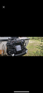

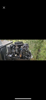

I had just purchased a A new boat to me that came with two 1989 OMC 120 Sea Drives One running one completely dismantled my father passed away and left me his brand new Johnson 140 horse 1995 if I remember correctly my question is can I take the powerhead off of the Johnson and put it on the OMC
Here are pictures of both powerheads the first two are the OMC
Three and four are the Johnson
Please any help would be very much appreciated

They are both Loopers. However they are different HP so, that makes pairing them up iffy. A lot of Parts in/on the powerhead could be different. That includes the Block, Carbs, Induction System, Exhaust Tuning, to name a few. A very thorough look at the Parts Lists of both will need to be done

From what I can tell both mid sections use the exact same bass gasket from my research the only difference in those two motors is bad the carburetors are different that is it
