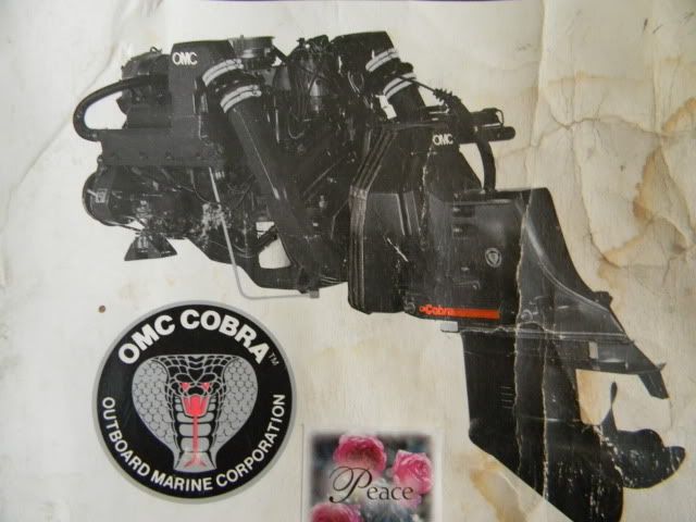

Ok the bellows go's inside there will be a tube that the cable runs thru it should be on the starboard side. Lift your motor cover and take a look you will probably see the old one still on if you did not change the cable.
With the outdrive I did have to tilt mine down just a touch to get it on once it lines up slips right in all the way I did have it on a motor hoist also.
Look on the outdrive where it has OMC on it right above is your bellows. That is inside the boat. Good luck....
