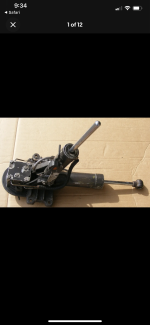

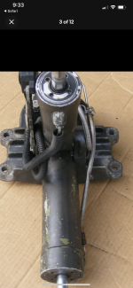

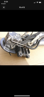

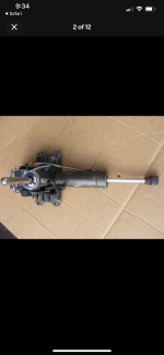

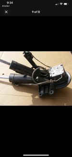

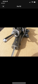

Hello all:)
I’m bought a 1990 Larson Center console and am having trouble locating the Power Tilt fluid fill screw.
I’ve looked all over for a week now. Any help pinpointing where the filling location is so greatly appreciated.
I purchased the service manual and it shows a plastic reservoir tank for the fluid, however, the person before the person I bought it from apparently had that hooked up to the oil hookup on the engine….Which is no longer in use now and us premix..So who knows..
The problem is we get very little tilt up and no disk at all. Blessed the lines 4-5 times and then we were able to get up working just fine, but still no down. But it is making a change in noise when it try’s to go down, just no movement.
Thought we’d try to check the fluid first.
Any ideas would be greatly appreciated!
Ryan

Hi and thank you for responding Mohawk. So at the other end of that pump is where the fill screw would be located?
Mohawkmtrs
Jan 13, 2010
564
The motor drives the pump, the pump pushes the hydraulic fluid to the cylinder(s)...the fill screw is on the pump.
