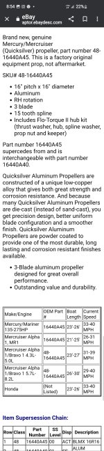

This prop looks interesting. What's your take in this.
16x16. Should add 150, 200rpm.
