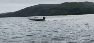

Seems to be a fair number of old Glastron on the continent. I’ve got a very rare UK built Roger Clark Glastron CVX16. She’s from 1984. Seriously quick machine. Next year she should see into the 70’s with more prop. I notice you guys on the continent often have meeting with other owners. Excellent stuff. Wee picture of my wee boat

Very nice boat! Sure, our CV-27 can't be so fast, but I want to make it near to the specifications :)
