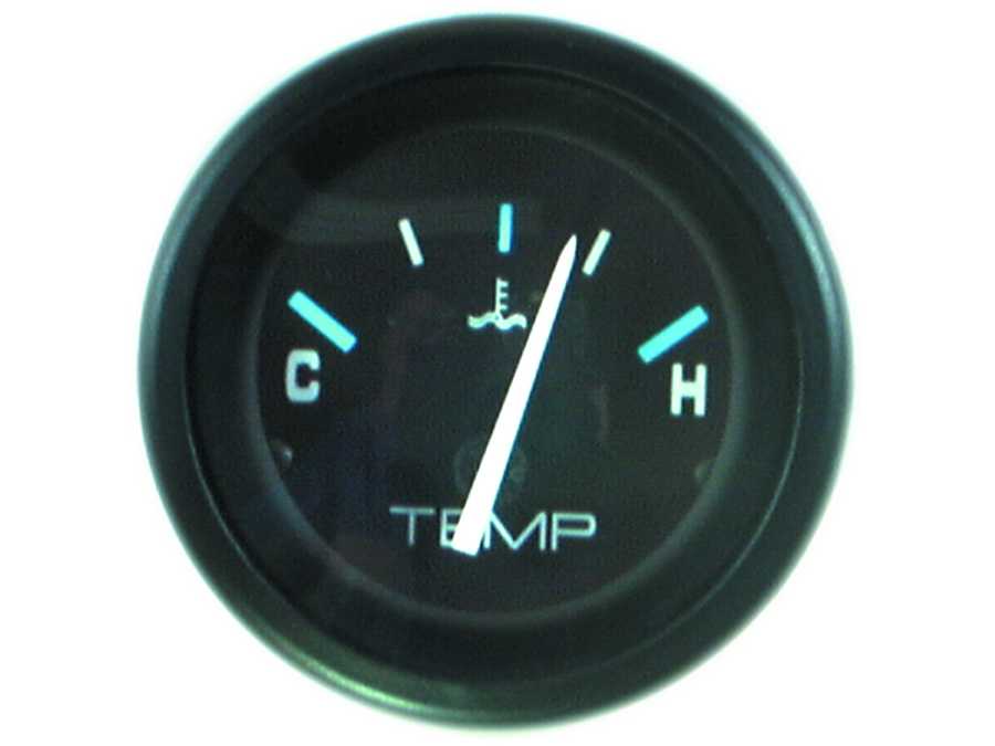

First you make sure horn and sender work as it will alarm @190. Pressure gauge you can see the t-stat and poppet open with the pressure drops. Also if pressure to high can tell if poppet or t-stat stuck. Factory OEM gauges do not have numbers but a area needle falls in....If it has numbers its either a aftermarket or 4 stroke gauge
