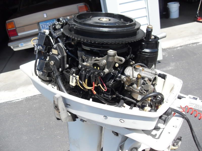

Here is the motor in question, I need the year to order a recoil starter spring, iboats part# ? all help appreciated.

I think it's a mid/late eighties motor. Not much help I know but without the numbers I can only guess.

According to the ignition coil part(582508) number in the picture the year of the motor is somewhere in the 85-91 range but that is for a 25hp the 30 takes a different part number. Also i see ur fuel pump is missing in the pic #3.
I believe this is the recoil spring you need it covers all motors from 85-01 in the 25-30hp range. just double check it first before you order.http://www.boats.net/parts/detail/brp/B-0395460.html

i would guess 88 or 89

It also looks like the rear mount for the recoil start is missing. Is the motor rotating and has fair compression ? It looks like it was very wet with salt water once, but it doesnt have to mean anything.
