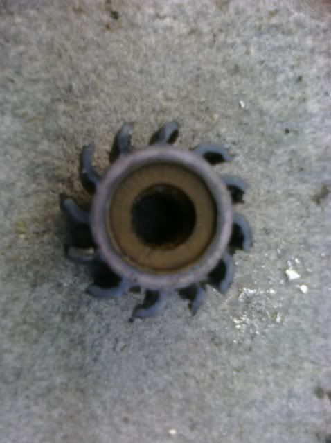

Take some pics of your melted impeller for us to see.

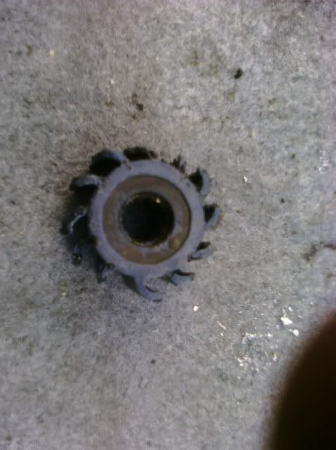

I would say it is more chewed up than melted but here it is. I think I am gonna list it on Craigs list as nice impeller just needs minor work:D

Re: Pics Added As Requested Yikes Burned Up My Impellar Today! Any Damage Done?
Looks like a fine quality piece there.
Seems it needed to be replaced anyway. Looks old as heck but that could be b/c it was on fire. :D
A little JB weld and Sea Foam...you're good to go.......
I think you have some fishing to do to find all those pieces that came off.
