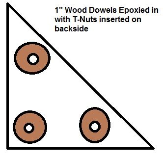

Here's what I'd do. I'd use a Drill with a 1" Forstner Bit to drill a flat bottomed hole about just shy of going all the way thru the existing piece. I'd then buy a piece of 1" hardwood dowel and slice off a piece that would be the depth of the hole. Then drill a hole in the patch pieces to accept the T-nuts. Mix up some 5 minute epoxy and plug the holes with the T-Nut patches. Put scotch tape over bottom of the t-nuts so epoxy does not get in the threads. This should be a good fast strong temp fix you can do in an hour or less. Hopefully this BAD drawing will help convey what I'm trying to say...

Thanks Woodonglass for taking the time to come up with a solution.
Unfortunately, the plywood seems to be pretty water logged, and I think it will take too long to dry out enough for the epoxy to bond. I think my best temporary solution at this point is to sandwich the 3/4 ply with an aluminum plate on the backside of the ply, under the upholstery. I can't believe I'm already seeing rot in the ply. As this was replaced, by Larson, only a few years ago, I would have assumed better quality.
