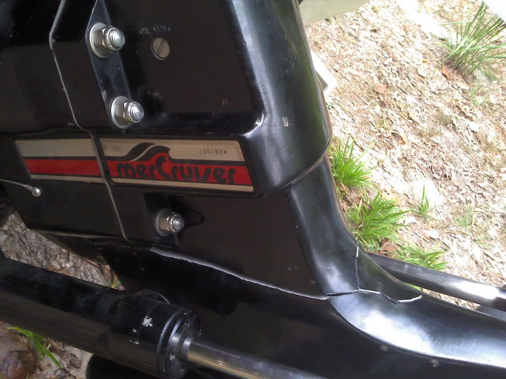

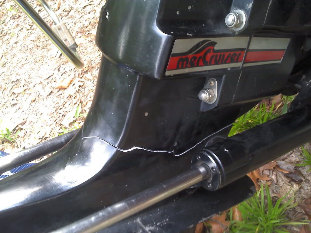

Took a stump a little too hard at the lake today in my friend's boat. Cracked the housing all the way around as you can see in the pics. After I hit it, I could feel only a slight vibration and was thinking maybe I had to buy him a prop. I drove it slowly for another 10 minutes to get to the pier. I knocked it out of gear, but then was going to bump it into gear to get it just a little push to the dock. At that point it would not go into gear at all, like a sheared pin.

A complete rebuilt upper gear case will run about 700 bucks. The lower gearcase may still be ok but only a teardown and inspection would verify that. From the looks of it the failure to go back in gear might be a result of misalingnment of the shift rod due to the crack. If the oil comes out clean with no water or a lot of metal shavings it might be ok but a least I would replace the top seal due to it running slightly out of kilter and making vibrations. Another option would be to find a used upper housing or a used housing only and trade usuable parts for damaged. This is not a beginners job but could be done by someone with a fair amount of mechanical knowledge and the FACTORY ONLY repair manual.
This will give you an ideal of what you are getting into on a 25 year old boat. I take it your buddy did not have hull insurance. Search around and you might find a used boat for sale with a good outdrive and a blown engine or a crappy rotted hull for a few hundred and switch the outdrives and bury whats left over someplace.
