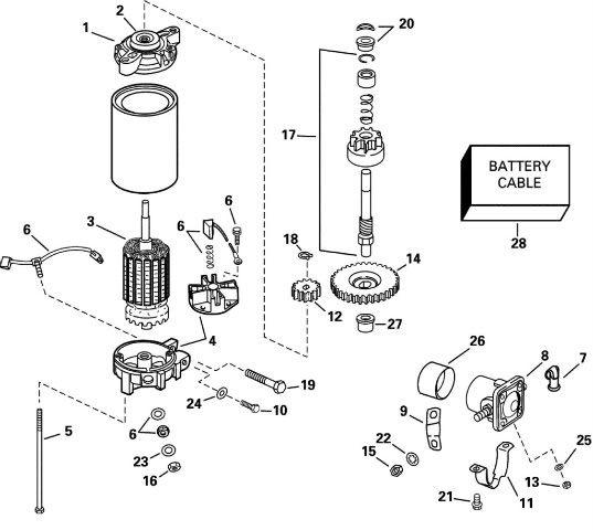

Here's a parts diagram if you need it:
Have you pulled the cover and watched the bendix for movement when you spin the starter? If so, is the gear moving up, just not far enough?
When is the last time the starter worked as it should? If it was recently, and some oil on the bendix shaft didn't help, then insufficient amperage is likely the problem as tashasdaddy already said.
Good luck ... a broken boat sure can screw up a vacation!
