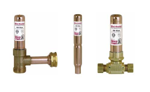

Also, Follow your pipes, Make sure they are tight and secured with proper clips. I've seen it too many times with wires and nails.
You can put on some Mini restors.
