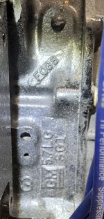

Thank you. Just getting into the project now and was looking at using this motor as a test to hone my skills since I already have it. Here are pics of some of the numbers casted in the block. The Single Number, I believe is 638 is on the sides of the block. The other pic is from the rear of the motor. I could not locate the casting numbers on the Heads unless the manifold is blocking them. Thank you for great information. Cheers, George

50,702
Head casting numbers are under the valve cover.
Block comes back as 1988-1995
