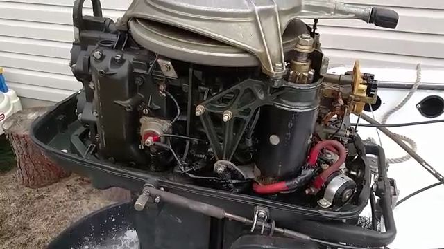

Going back to tune up.
1.) The little thing with a spring on it, where the throttle cable attaches, well that is sure plastic and it was broken to begin with.... any ideas if there's a replacement way to fix this or do I really need it.
https://www.dropbox.com/s/fyj5xkynb1bpkua/VID_20150811_112134471.mp4?dl=0
2.) I'm attaching a video and you guys let me know if she's running good. When starting it, and leaving it in that position .... it has this clunk that I didn't hear before putting her in the water that I do now, is that a spark plug misfiring ? engaging it to slower or faster throttle stops it... but just half way, she does that clunk. Suggestions?
lindy46
Nov 27, 2008
3,886
Not sure what spring you're referring to in question #1.
That "clunk" is a lean sneeze - open the slow speed needle about 1/8 of a turn and see what happens. Other than that, engine sounds good. You may want to adjust the idle up a little bit at the motor. FR describes the procedure in post #4.
