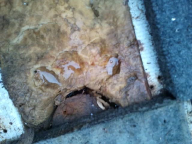

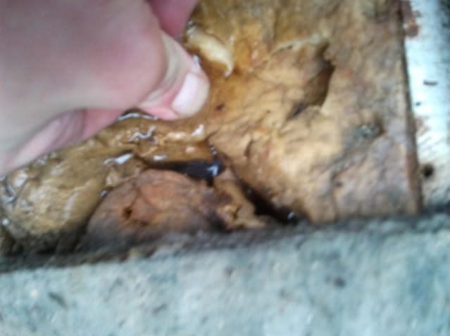

So I went out and pulled up a piece of flooring on the port side and low and behold, it's soaked with water. Even worse, pour in foam :facepalm:. I guess I'm going to have to pull it all out and i'll replace it with foam sheets. I'll take t out a few more times to make sure I got my leak fixed. I'll post pics shortly, need to put the cover back on before the rain starts up again :eek:.

The ugly:

Re: Potential waterlogged foam
Oh the horror! The humanity!!
:eek:
One more thing to add to the list but she'll clean up great all the same:D

Be sure and check all the wood structure well while you're in there, rotten wood generally goes right along with water soaked foam...

Ill tell ya im.doin a resto on a searay and my foam was wet not completely soaked but wet and the stringes were rotten so.i pulled the floor up and the stringers out and let it sit in the sun uncovered for about a week and i used a shopvac and kept sucking the water out and to the best of my knowledge the foam dried upthere is no.more wet spots no more water leaking from it so i replaced everything except the foam and it seems to be ok

Ya you can dry out the foam but it won't stay dry. Once it gets saturated with water it acts like a sponge, sucking in all the water. Basically you would have to re-dry the foam every year and I would rather just spend the money now and replace it.
