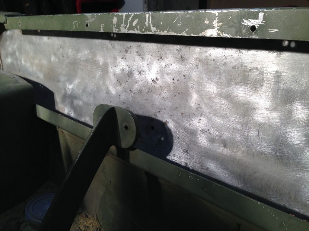

I mentioned this in another thread and it was suggested that I start a new threat for this, so here goes. I recently bought a 14' aluminum flat bottom that had no transom board. Boat looked good on inspection so I brought it home and put in a pressure treated 2x6. I had never heard of the new PT chemicals reacting with aluminum. Luckily, I only installed it a few weeks ago. I removed the board yesterday and found quite a bit of putting. I'm pretty sure the previous owner had used PT as well because there are a couple places where there are pinholes all the way through the aluminum skin. I know there was already one because the boat had a very slight leak and I couldn't figure out where it came from before. That was within hours of installing my board. Anyway, here's a few pics of the damage. Someone suggested filling with jb weld. Is that the standard procedure? I'll be buying 5200 soon for another project. Would that be any better or worse? Or gluvit? I'm assuming any of them will probably work fine. Anyway, here's a few pics of the damage. Worst area was where the knee was bolted in. I'm assuming because there was better contact there.

Clean that aluminum area with the pitting real good. get all the white crustiness off. I used 50/50 cleaning vinegar and water. Adding some self etching primer and paint may add some protection against future corrosion also to that area that is bare aluminum.
Id use jb weld for the pitting and sand it back smooth. Im pretty sure the 5200 and gluvit wont be long term fixes for the through hole spots.
Don't over bore and fill with 5200, I didn't use that method but I think what youd fill the over bored hole with is a 2 part resin and let it cure hard, then redrill to the correct size for your bolts. The idea behind that is to have that hole as hard as wood with out water actually contacting the wood through the bolts holes. 5200 will be good for sealing the bolts and washers after that for added protection. Use all stainless steel hardware also.

If you thin JB Weld with just a bit of acetone it will fill and flow much better. I've used if for a Lot of aluminum repairs on motors etc and this has always worked great for me. Wet Dry sand Paper and wet sand the affected area and then give it the Vinegar water bath before applying the JBW!!! then a Light dusting of Self Etching Primer followed by several good coats of Clean Metal Primer before installing the wood core.

Thanks for the advice. I was mistaken about filling the holes with 5200. A lot of what is in the picture is rust stain. Not sure where that came from. When I bought the boat the wood and hardware were already removed. I put the 2x6 in as a quick fix since I had it laying around. I'll be cleaning and JB welding tomorrow. And I'll add the primer and paint as soon as I can locate some. Walmart didn't have any of the self etching primer tonight. I should be able to pick some up tomorrow when I get the plywood for my 20 ft project. Thanks again for the help everyone. I'll post some pics along the way.

Made some progress today. Went to the only store in town that sells plywood, only to find out that every exterior ply they carry in stock is pressure treated. Went ahead and bought the Titebond III and self etching primer though. Here's a few pics of the progress today.
Step 1: Used a wire brush on the drill to remove all the rust residue and get down to clean aluminum. What I couldn't reach with the wire brush, I did by hand with sandpaper. It was amazing to see how much pitting there was after sanding away all the residue. I started out thinking there was one pinhole all the way through the hole, but realized there were actually about a half dozen that made it all the way through.
Step 2: Clean the area. Mine was very dirty, so I blew it out, vacuumed, then cleaned/degreased. Then I mixed JB weld and a few drops of acetone to thin it down, as suggested by Woodonglass. Great idea. I used a small 87 cent plastic scraper from Walmart to apply the mixture. Fill in the gaps, then scrape it clean. I did a small batch first without acetone because I couldn't find it. I quickly realized that it would be very helpful and make things go much faster...especially important with the fast setting JB that I used. I highly recommend adding the acetone. Thanks again Woodonglass.
Step 3: Repeat sanding after JB has set. This removes all of the JB residue between the pitted areas and cleans them for primer.
Step 4: Apply light, even coats of self etching primer. I did this over the entire transom board area, but also applied it to a few areas where the paint had been rubbed off from loading in a truck, etc. 3 coats was recommended, but I ended up doing a little extra to finish off the can. BONUS, my primer was almost an exact match to my paint color.
Picture of the finished product, ready for the transom board. You can see some small dimples under the paint where the pitting was, but they're very minor. I wasn't going for 100% perfection there.

Looks pretty good mckinney004, You did a good job cleaning it up in preparation for the new transom wood. How do you plan on installing the new transom wood? I see a metal cap and even a metal channel on the lower section. So what is the plan? I also see that the wood will have to go behind the two side seat like sections. Looks like that wood was originally installed before the top cap was installed. I can't see any other way to get it in when they built the hull.
Also, are there any weep holes in the lower metal channel to allow water to drain out? That would be a great idea if there are none now. Other wise its traps water in there and makes the edge of the wood sit in water until it dried out. Some holes would make the new transom last even longer. :noidea:

Thanks for the heads up on the primer absorbing water. That bottom channel is riveted in place, there is a little wiggle room between the channel and the aluminum skin, so the water could slowly drain. However, since I already have access to it I think I'll go ahead and drill a few holes.
