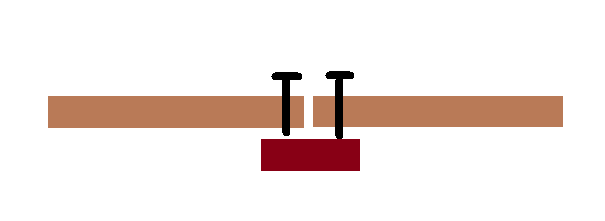

Any suggestions for how to join the pieces of plywood at the seams? Since the opening is about 6'X12', I won't be able to do this with a single piece of 4X8 plywood.
Should I just butt the pieces together and glass over them? Sounds weak.

Re: Pressure-treated vs. marine plywood in a 1987 Bayliner floor restoration
Lay the pieces as 6'X4', you'll need 3 total sheets of plywood cut to 6' wide, running the width of the boat, starting from the transom headed towards the bow.
Plan the joints to fall on a bulkhead running port to starboard between the stringers. Or add a rip of plywood to the long side of the plywood as a doubler, creating a ledge for the next piece to lay onto. Use gorilla glue & screw the plywood down to the doubler, like this:
