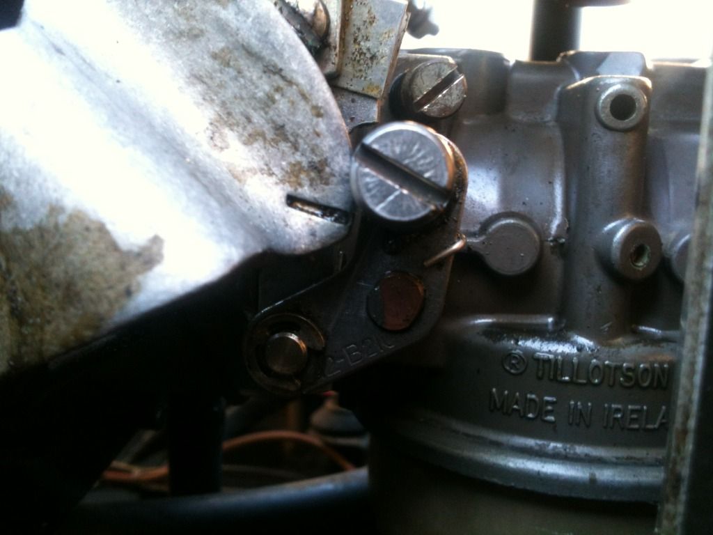

thanks for the instructions. I am able to get it to idle at 1100 rpm's on the muffs now after adjusting the idle screw 2.5 turns clockwise and cleaning out the idle port and resetting the idle air mixture screws. here is a pic of where it is at now. does this look normal. by adjusting that screw for the idle, did i change anything else that i would notice on the water or is this just for idle? Now that I know this proceedure, i will take my tools with me to the lake this weekend for some fine tuning on the water. thanks again

Congratulations! Now you can start fine tuning it. First things first, 1100 RPM on the muffs is about normal. Now you can fine tune your air screw. To do this you need to warm up the engine for about 10 minutes and then start turning the air screw out (CCW, one carb at a time) slowly while listening for the engine or watching the rpm gauge. Usually, you can also tell by listening to the engine sound. Anyways, keep slowly turning the air screw CCW until the engine starts to cough or starts to have rough idling (due to rich mixture) and then stop. Mark this position and now go back and screw in the same air screw CW while listening for the engine sound. Continue slowly until the engine starts to cough or have rough idling (due to lean mixture) and then stop. Mark this position. Now set this specific air screw midpoint of the two mark points. After setting the first carb air screw check the idle rpm and if it went higher or lower re-set the idle screw (NOT THE AIR SCREW) and set it again to approx 1100 RPM. And then do the same for the other air screw on the other carb. And then again check the idle RPM and re-set to approx 1100 RPM. Now you should be good to go in the water. While in the water, the idle RPM with the engine idling and gear engaged, should be around 750-850 RPM. If you need to, conduct fine adjustment on both air-screws and idle screw as required.
In the pic you are showing the elliptical screw where the line on the cam and the slot on the screw should be lined up if the idle screw is set all the way in. As it shows, it indicates the throttle valve is slightly opened as adjusted by the idle screw. Good work!
