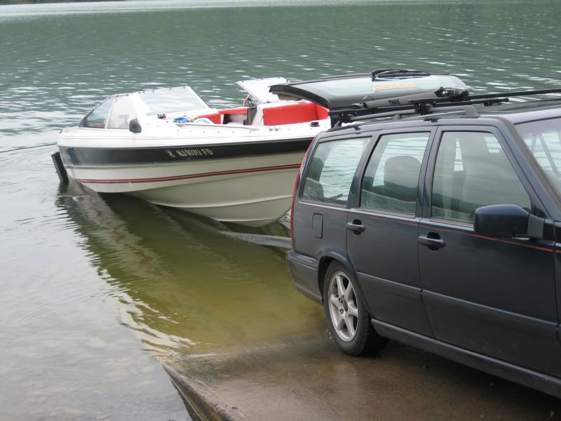

Took the boat out for the test launch yesterday and when I started the engine it started reving really loud until the alarm went off and I shut it off. All off this was in neutral just sitting on the trailer. So I didnt launch it, but then today I hooked it up to the earmuffs and started it up. Same thing, prop turning in neutral. My only idea is that when I hooked up the controls I pulled the throttle closer to hook up the cables so it may be trying to rev in neutral. I'm not sure, any ideas? Also forgot to mention its a 1988 Johnson 140hp model # J140CXCC.

Re: Prop spinning in neutral
really hope you wernt starting motor on trailer without water at the launch!
no, no, I had the boat in the water, but was still resting on the trailer.
