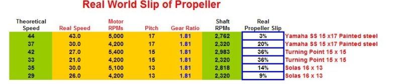

Jersey, if these are GPS speeds I would be surprised, as I show you with a 3% Prop Slip on the Yamaha 15 X 17, I presume that is their Painted Steel semi cleaver prop. The Turning Point shows a Prop Slip of 36% at 4,200 AND 5,400 RPM and that doesn't make sense, and the Solas shows a Prop Slip of 9% at 4,200 RPM and 14% at 5,100 RPM and I usually never see an increase in prop slip on a planing hull at WOT RPM. I believe the numbers you are giving us are not exactly the numbers that the boat attained, possibly you just remembered wrong, as I do regularly. I am NOT attacking you, just trying to figure this out and help in any way I can.
I would very much like to know the base weight of your boat, degree of deadrise, how many people and extra weight you carried on these test runs, and did you run them the same day and did you run in one direction and then turn 180 degrees and run in the other direction then add the two numbers together and divide by two for each prop test to negate the possibility of currents affecting the test results.

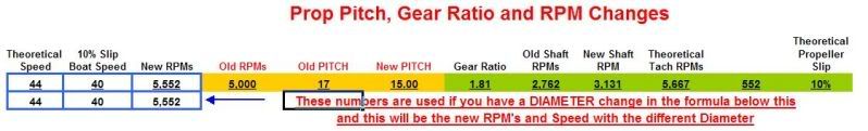

I show your motor to have a 1.81:1 gear ratio and recommended WOT RPM to be 4,500 to 5,500 RPM, if these numbers are right I ran some figures and they are below, I also show that if you changed to the 15" pitch in the Yamaha prop you will gain about 500 RPM which will put you right at the MAX rated WOT and probably lose about 1 MPH at top end. BUT if that Yamaha 17" Pitch really has a prop slip of 3% I can't imagine that the 15" pitch will do the same. THe only time I have seen prop slip like that was with a Yamaha Performance series prop that couldn't turn but 5,050 RPM and WOT should have been 6,000 RPM.
Here are your Prop Slip Numbers
Prop Change
While I am at it, I will also state that the blade flex most people talk about with aluminum props at speeds lower than at least 45 MPH is not a viable statement in my opinion, if it was then aluminum props would attain more Prop Slip as the speed and RPM increased because of the water pressure exerted on the blades at these speeds in a boat, and in fact that is NOT the case if you will study the prop slips of most boats with aluminum props. Because as the speed increases you will notice that the Prop Slip decreases all the way to WOT RPM, and if aluminum prop flex was true you would see Prop Slip go UP as the RPM went up not DOWN. The MAIN difference in aluminum and stainless steel props is in thinner blade thickness because of the difference in material strengths, which makes for less disturbance in the water flow between blades as they turn with stainless props, as the stainless blades are much thinner. And the MAJOR difference is in blade GEOMETRY of propellers built in stainless steel that is NOT incorporated into most aluminum propellers. The only props I know of in aluminum that have a LOT of blade geometry changes in them is the Turning Point Props and they certainly act more like stainless props than aluminum props.

hwsiii, i have to agree with some of your statements. I mic'd the aluminum props, there's no way i putting out that type of horsepower to flex thoose blades that much where it will hinder performance. All theese numbers were aquired through gps and speedo (both are dialed in together, in case gps were to take a crap). I believe my conclusion for the performance results lies in ear design and cup. The yamaha prop is not painted, it's not shinny anymore either. Also which you can not wrap you brain around also because you can not physically see it is the hull design, this also plays a big part in this. it is not like a typical mako/sea ray/ regal. It is long and narrow, very similar to a WWII destroyer

I do not believe that you can do any better than what you have with the Yamaha stainless now unless you changed to the 15" Pitch in the same model, and I am not positive about that. But if you can borrow one I sure would try it to get the RPM up to maximum, it should increase your hole shot and time to plane.
