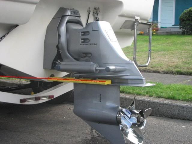

I read a little closer and picked up on " Your cav plate is below the botto" if your cav plate is below the bottom of the hull that is the problem. Here's a pic of a I/O and the cav plate is 1 inch above the bottom of the hull. Now if i could raise it id be there in a sec....
Now the question is just where is your cav plate in relation to the hull???
