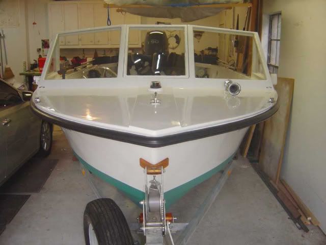

Re: Proper name for rubber boat bumber?
I've installed a few of these. They're pretty easy if you have a helper and if you follow the instructions. The ones I installed recommended warming them up in a tub of hot water to make them more pliable during installation. I've done it both ways and it's soooo much easier after they've been warmed up. :redface: There are a couple of manufacturers, but I've always used the ones made by Taco. You can find them here on iboats.
