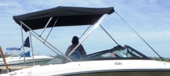

All biminis have a center fixed mount for the rods, with a second detachable mount for one end (either fore or aft). The opposite end is attached with an adjustable strap. It has to be that way or there would be no way to adjust tightness of the assembly.

Not all biminies have that strap. Mine is rigidly braced forward, with a braced bar forward and aft holding the top taught. No deck obstruction.
Obviously, a PO removed the strap and added a bracing bar in its place. As a matter of fact, I did that very thing eons ago on an old boat when the strap needed to be replaced. Poor choice on my part because the fixed mount would not allow tightening when needed.
Furthermore, my new bar was MORE of a deck restriction than the strap....
