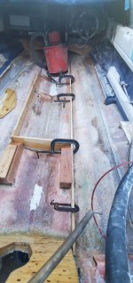

Here is a picture from my project showing what I mean.
Thanks Capri. Now see, that's what I meant by the boat "crease". When you ground out your old stringers, they was a 1/4" or so channel for you to put the new ones into. If I keep grinding mine, it'll just be a flat section of hull, because there is no boat "crease" at that location.
I just ground down to "clean" glass. The area the stringers were in had a slight angle to them and any adjustments I needed to make with the height of the stringers I took it from the wood. The crease as you mention I ran into under the console and altered the stringers to keep them at the height I needed for the floor. If you do accidentally go through the hull it can be easily repaired.
