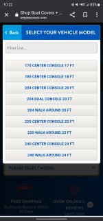

These are the choices for my boat/year and I'm at a loss for knowing which to choose for a cover.

It's not a center or dual so must be a walk around. Most call then open bow run about

Dingbat I looked up some boats selling and it looks like my boat is considered dual console for whatever reason.
