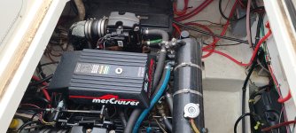

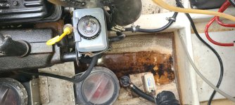

Engine temp alarm randomly going off, I believe due to overheating possibly due to cavitation. Previous owner converted engines to fresh water cooling and added sea strainer baskets. When running air collects in sea water strainer.(See pictures attached).

Should not be pulling air
Is the strainer fed by the drive, or by a new and dedicated pickup?
50,932
I would look between the strainer and the drive to find your air leak.
I would also invest in two pickup castings
