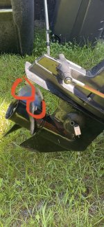

Spin that prop by hand and see if it’s hitting that trim anode fin behind it. Sure sounds like it.
I’d also take the prop off and check the hub kit it has. Make sure it’s ok. Make sure it’s the right prop too and the thrust washer is present. Otherwise ir will be perhaps contacting your gearcase exhaust cavity

It’s definitely the trim anode fin getting contacted by the prop. Can actually see the contact marks on each blade of that new prop. The paints off it where it’s been hitting it

That looks like a large distance from the outdrive barrel to the raised edge on the prop. I think he has the wrong thrust washer or it's installed backwards.

In addition to my post about it contacting the prop (clearly is)…the fella with the post above there..might have a point too. Could have the wrong or wrong way about washer there. But also should be known that some props available for the alpha one, require the slightly cut down size of trim anode fin installed. Had to do this to a boat not long ago, for a tempest prop to not contact.

Picking up on @QBhoy 's comments. The trim anode is unnecessary with power assist steering. Flush anodes are available and will prevent this and trash/wood getting caught and bending your prop.
Easily changed. Pop the plastic hole cover and use a 3/8" drive 1/2" socket with a longish extension to loosen the anode. Be very careful to keep the cap screw through its hole by keeping the wrench on it. If it comes loose inside the lower housing it's nearly impossible to get it back into place w/o dropping the lower hsg.

Agree…wasn’t sure if it might be one of the 3.0 with no power steering. Usually the only reason an alpha might have such an anode perhaps, rather than the flush fit anode, found on the larger power steering equipped arrangements. All the best

Take a file or grinder and grind the tab down where the prop touches

Not long ago…I witnessed the quick version of this solution in action. Turns out that a good quality stainless steel prop, makes a fine and surprisingly precise job of finely machining and adjusting the anode to suit !!! Just the one loud clatter is all it took…haha !
