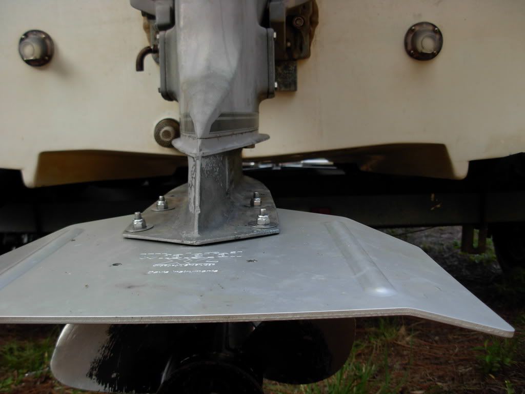

Sleeping on it helped to clear my head. I understand what you're saying now, and 17P sounds right. The antivent. plate, if I called it right, is about even with the bottom of the boat, maybe a hair lower. I put a Whale Tail on it, thinking that would help get it up on plane quicker, but it's dragging low in the water while on plane. Maybe if I raise the motor one bolt hole, about an inch and a half, and get rid of the Whale Tail, maybe it'll help with the hole shot. Is my think correct? Thanks for your replies.

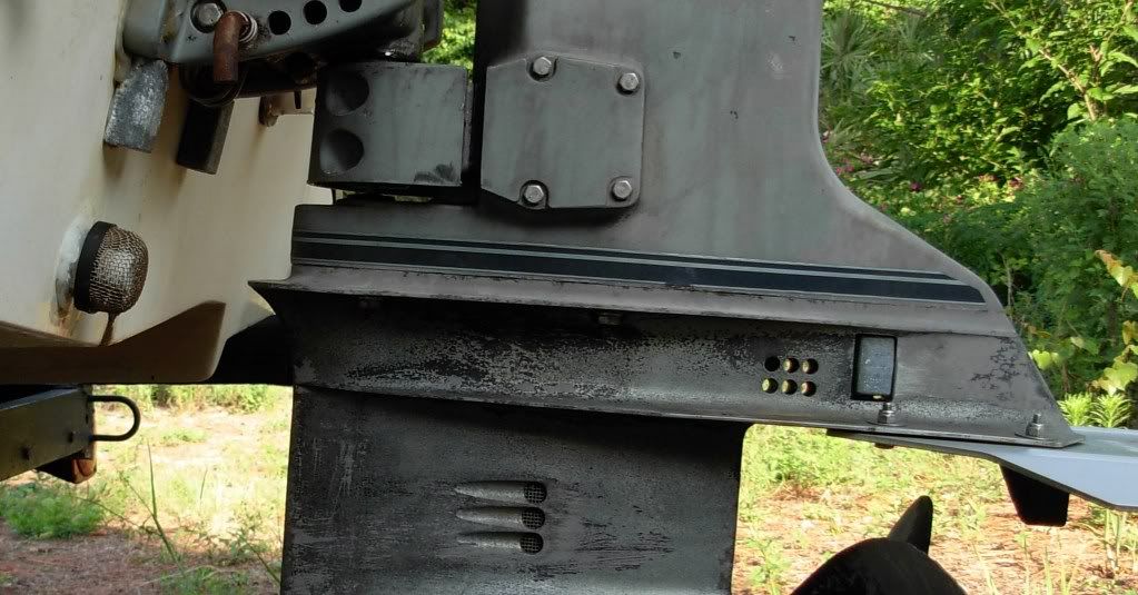

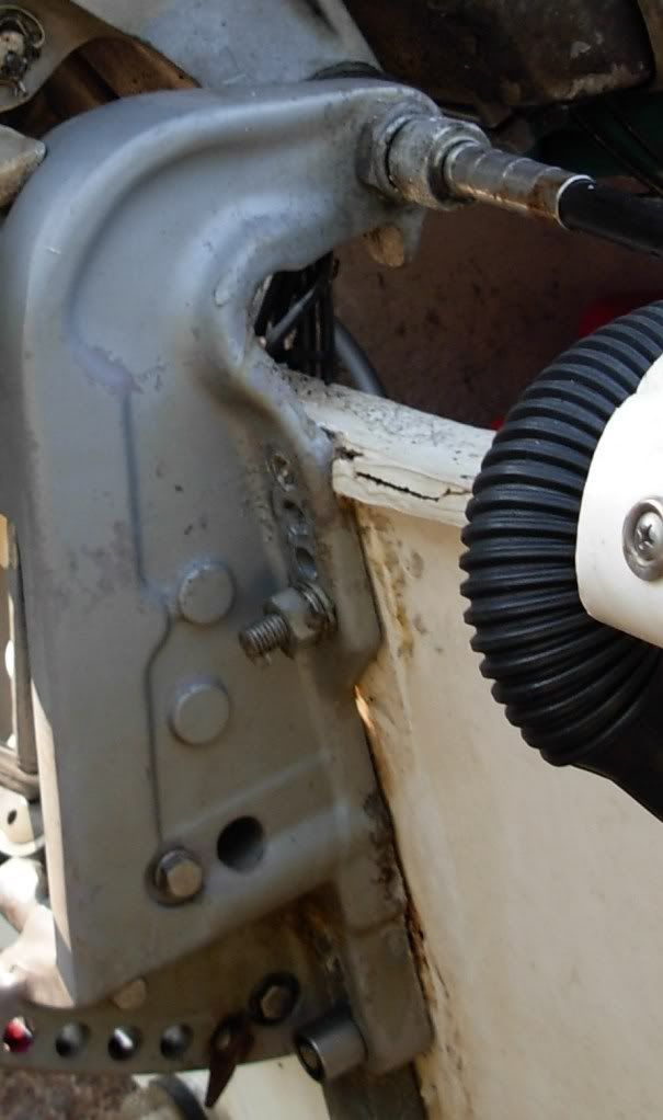

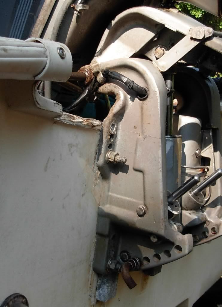

These pics show how the motor is mounted. Looks like it could be raised a couple of inches, to the 2nd hole from the bottom. In the first pic, the camera is aligned with the bottom of the boat. The motor is tilted all the way down. Thoughts?

A 15" pitch should be right.I saw a test with a 850lb boat with a 60 Erude w 15" prop 2 men 25lb gear and 6 gal of gas that has a little over 3 second hole shot.The foils should be a last resort.Do you trim down all the way for hole shot?A 4 blade prop would help hole shot But I think a 13" prop would be extreme It would be normal to drop an inch going to a 4 blade. 14"
Is there a lot of weight in the stern?From your description I wonder if the foam under the floor may have absorbed water.Raise the motor to a point just before venting becomes a problem.
It could make a slight improvement in hole shot, top speed and rpm.

You should us a straight edge to get an accurate measurement along the keel to the foil.
You appear to have a very slight tunnel effect, may change your height in relation to the bottom.
But raise it as far as venting allows.Some motors have holes on the bracket that allow raising the motor without needing to move the transom bolts.

No holes in the bracket, have to raise it using the transom bolts.

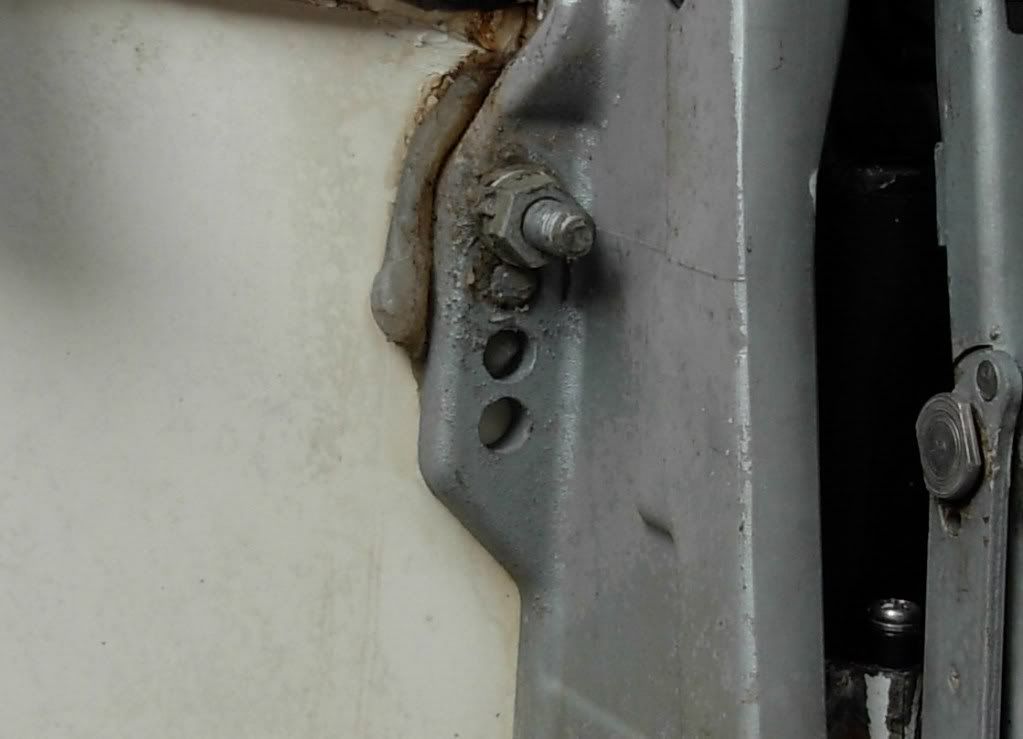

Ran a straight edge along the keel, and measured DOWN to the anti cavitation plate that the Whale Tail is bolted to and it's exactly 2 inches. The bolts in the bracket are in the top bracket holes, and there's 2 inches to the bottom bracket hole. Soooo, if I raise the motor and use the bottom holes, the plate should line up with the keel plane. I'm new at this, but I think that is a big part of my problem with the motor too low. I'll raise it and try it out for getting on plane and WOT rpm's before I even think about a different prop. Unless someone has a better idea or a different approach to this. Darn, I'm soooo close to having a nice fishing rig. Thanks steelespike.

Measure the X dimension when the AV plate is parallel to the keel, not trimmed down all the way. It still looks like you'll be low especially with a fin. The fin should allow some additional motor height (X dimension).
As for the rpm, the motor is rated at 5500. You can safely run that motor at 6000 all day long. For motor longevity you should target 5800 to 6000 as your top capable rpm with an average load. There really isn't any such thing as "over reving" that style motor. If you're using ethanol fuel you may not get to 6000 with the right (most efficient) prop anyway.

Thanks, Dhadley, I'll re-measure it, it'll be less than 2".
Went to oil up and loosen the mounting bolts, and the lower starboard one looks like it has one of those "locks" like on a car wheel, where you need a special socket to remove it. Darn the luck. Anyone ever seen one on a boat mounting? Guess the prior owner didn't want anyone to steal the motor. It's like an inch piece of pipe over the nut, and recessed in the pipe is a nut, I guess, with half holes around the edge. A special socket, I guess again, fits down inside and tits around the socket edge engage into those half holes. Sawzall, looks like, and hope it isn't hardened steel. Any ideas?

Its possible its just meant to spin making it difficult to saw off.Might cut easy if you can keep it from spinning.If all else fails maybe grind it off.

I crunched down on the anti-theft piece with vicegrips and spun the bolt out from the other side.

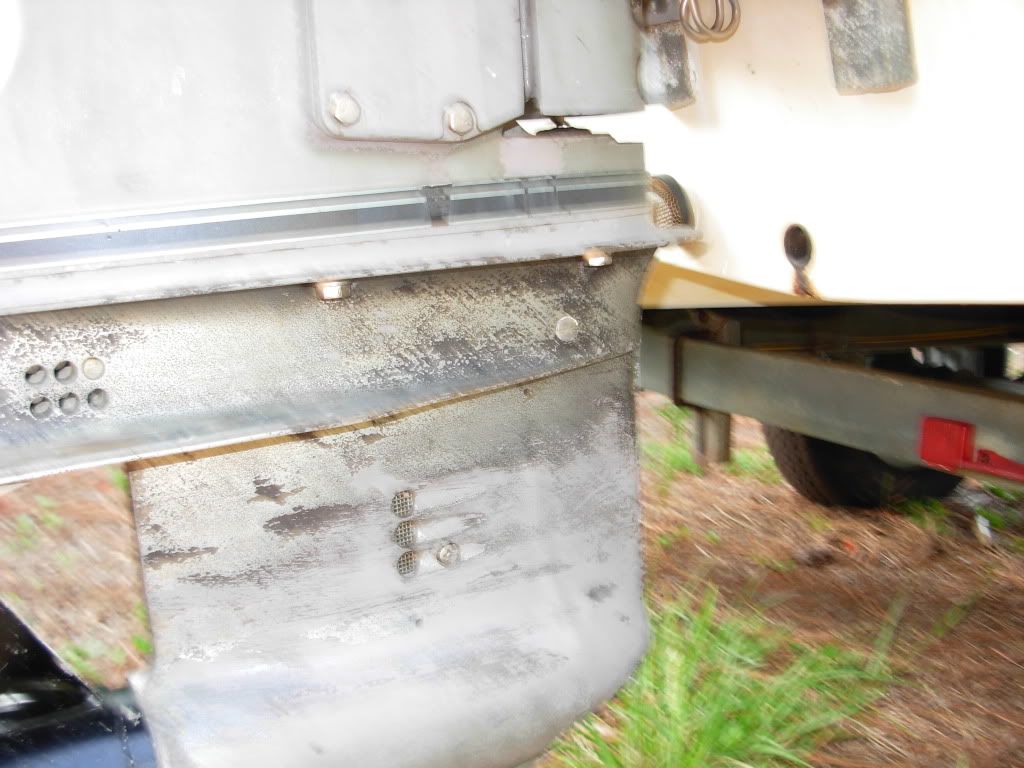

Raised the motor this morning and now it's 1/2 inch above the keel line, with the motor plate on the same level line as the keel. Used the same bolt holes in the transom. Here's a couple of pics, still need to tighten it up as soon as I get a new bolt and nut to replace the anti-theft device. I guess it shouldn't be undue strain on the transom sitting that high, since the same bolt holes were used. The transom is solid as a rock, just chipped some fiberglass around the top area. I'll seal that up. Thanks everyone for all the help. I'll report back on the test run.

Ok here goes. 1996 Sailfish, 17' length, 8' across beam, I think the weight is 1500 lbs. , motor is a 1988 E60TLCCR. Moved the motor up as described above, cav. plate 1/2 inch above bottom of keel line, prop is alum. 13.25 x 15 pitch (borrowed, finally found the stamping). Runs like a champ, 8 seconds to get on plane, top rpm is 4900, slowly creeps to 5050. Speed is ?, speedo doesn't work. WOT range of of motor, per book, is 4500 to 5500. I gotta give the prop back, so here is what I'm thinking.
