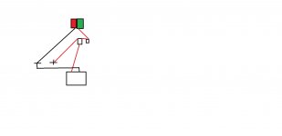

Should these switches be wired this way? Currently, or the way it DID work, is the navigation lights came on when you turned the left switch on, and the anchor light came on with the right switch, BUT, the right switch got power from the left switch when it was in the ON position. So the anchor light could only be on with the NAV lights..
The regulation says that at anchor, the white mast head needs to be visible for one mile on a clear dark night.. Does the nav lights need to be turned off? I mean this is a 14' runabout, realistically I'm not going to anchor in this boat for an overnight stay. But I want it right in case I do

Left/Right means nothing to me.
Normally there is one switch with a center position which is OFF
One direction turns Nav and anchor lights ON
The other direction turns only the anchor light on

Ok, so my boat was wired backwards from what was needed.. As long as the anchor light gets the power source, and the navigation lights feed from that switch, it will be as it should be. This is my janky MS paint diagram. My wiring is neater with a fuse block and 2 negative buss bars. But this is pretty much what I need to do with the push pull switches, I think
