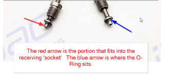

High pressure steel lines seal at the flare at the end of the steel tube. The straight thread flare nut on the tube doesn't seal. It just forces the tube flare on the male seat in the housing with enough force make a metal/metal seal.
These are not the typical flare type of hyd fitting that we are all used to. They are an unusual design and it uses an O-Ring. Here is a picture of the hose end. The torque is very low as stated above which is out of the manual. I suspect a ¼ turn would over torque it. The threads as OP mentioned are in fact 7/16-20. Why VP went this direction is a mystery to me as its not like any hyd fitting I have ever seen.

I feel your frustration. But do NOT flare your tubing. It will only be worse. And given that its stainless steel and thick I do not think it would flare anyway.

While it may be a challenge perhaps using a mirror or you phone to somehow get a look inside the cylinder fitting hole. Below are some pics I took of my situation albeit it was in the manifold block (other end of where the hose goes). And the drive was still attached! Note the highlight of the bad threads that cleaned up with a thread CHASER (not tap). Perhaps you may still have that last thread or two still not cleaned up. Only way to know is to look.
Also see picture of the ‘seat’. Not a great one but this is where the O-Ring sits and even with the poor quality of the pic, can still see that that seat is good to go. If it was not, I would not have tried to clean the threads, would have gone straight to changing the manifold.
Again these situations are so frustrating but encourage you to give it one more heave oh :)
