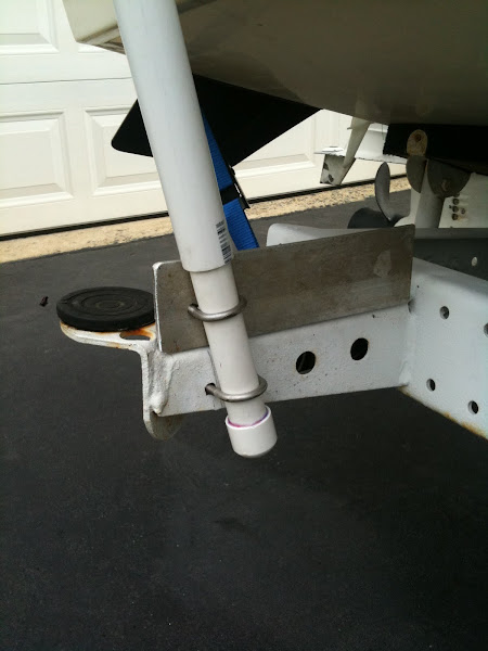

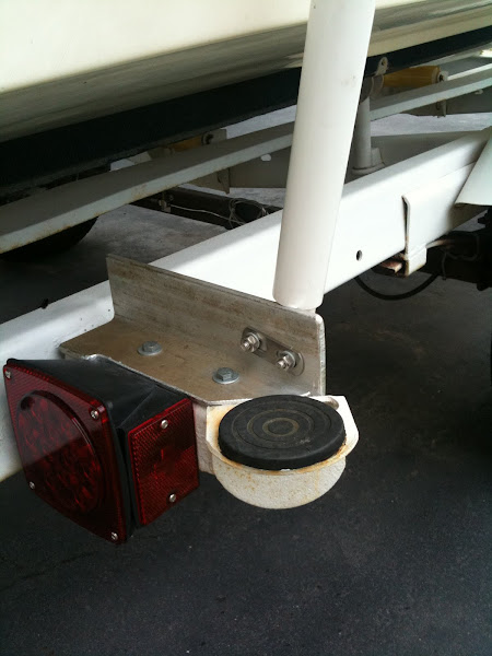

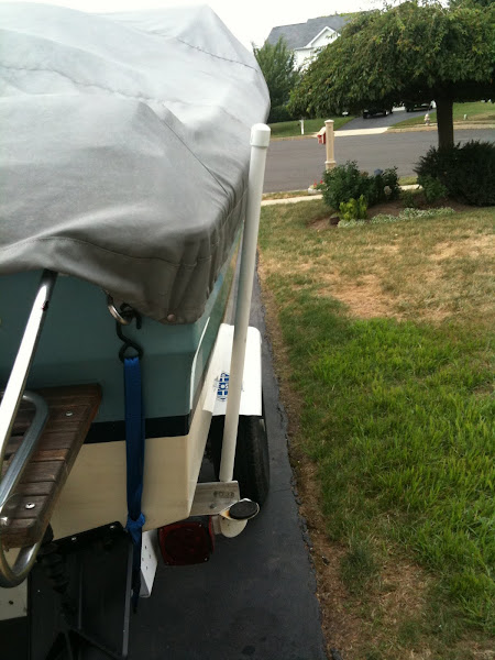

I'll agree with everyone else that you're in too far. I'd also agree with making guide-ons with PVC pipe. I made my own in about 2 hrs:

+1 for Superbenk's solution. I like that a lot- inexpensive, and easy/cheap to fix if something breaks. Nice!!

superbenk
Oct 27, 2008
2,033
Re: Re Winching on boat.
Thank you i like the idea of the pvc ones i will make them what size pvc did you use,
Thanks for everyones help much appreciated
I describe them in detail here: http://forums.iboats.com/showthread.php?t=429837
So far they've held up very well. Came in pretty useful on one especially steep ramp. They handled the weight of the boat very well as long as I'm easy on them.
