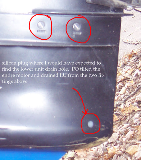

This picture is the only thing that has me perplexed about this motor, care to speculate?

The 3 screws are,fill and vent the third is a DO NOT TOUCH!!! The drain is under that screw on the bottom.It might be painted over.Look for it.
The a/b/c denotes small changes on the motor and trim system.Like connectors and small changes.
That color Force started in 87.Post a pic of your motor exhaust and ignition side.J

So, is that small hex screw the drain? He couldn't get it out of his boat, I was under the assumption that it was the screw that you didn't touch.

That silicone filled hole is where the shift pivot screw is located. I always recommend filling the hole for that screw with silicone RTV. It keeps you from accidentally removing it and it is extra insurance against a water leak there. See? It works! It kept you from taking it out before asking.

Yes the very bottom hex screw is the drain. Mine was stripped so I found a torx bit large enough and hammered it in the screw and it came out thankfully.

Who the hell designed that as a drain? Wow, that's a tiny drain hole. Guess I'll have to get that out of there and replaced with a better screw.
Anyone else have suggestions on dealing with this thing as far as getting it out? I'm not too worried about drilling and tapping this since anything that gets up in there is going to come out of the hole as the residual oil drains ( not to mention it wouldn't be too difficult to flush ).

I use a torch.Just a little bit of heat.Make sure the vent screw is open a bit.
I also fit in an allen head driver socket not the usual wrench.I tap it with a hammer.Do not over do the heat or tapping.
Those fail or you strip the allen head then a drill and easy out.J

That is a standard 5/16 set screw. There is PLENTY of meat where it is located. If you want to re-tap, you can go to a 3/8 X 16 and spotface to take the regular plug like the fill and vent. You can also tap out to 1/8 NPT pipe plug. There is enough aluminum that if needed, you can go up to 1/4 NPT.

Excellent. I'll be sure to do that. I wasn't too worried about the amount of metal in that area since it takes a bit of stress, but it's nice to have that verified. Too bad though, he had the LU off this summer for the impeller replacement...could have done it then.
