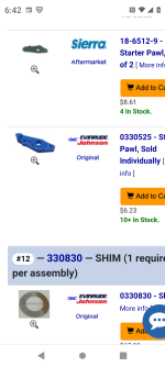

If all else fails, hit up your local marine parts supplier, they should be able to look that up and let you know. The big dealer/ parts marina in my area still have acess to older parts microfitch sheets. They seem to be able to find anything I have ever looked for.
38,802
0330525 available all day long.----Are there 2 on your motor ?

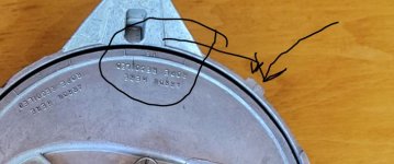

Ok I fixed the recoil installed 2 new pawls and 3 missing wires that connect the pawls. When I pull the rope handle the rope pulls out around 5 inches or more before making engagement with flywheel. Is there a way to shorten the distance the rope has to be pulled before it engages the flywheel?
38,802
Did you time the recoil ?----See the arrow on the housing ?-----See the simple instructions on the sheave ?.

This recoil assembly is " timed " to take advantage of the eliptical sheave !!-----Do not go changing the length of the roped by guessing.
38,802
Post #12----I believe it is clear when you look at the parts.----And do not worry about when pawls engage relative to how far the rope is pulled..

Ok. I loosened the half inch bolt on the underside and moved the sheave counter clockwise until the arrow was pointed at the words arrow here. Then retightened the bolt. Seems better now
38,802
The idea here is that at compression the elliptic sheave moves the rope outwards from center.----Gives you a mechanical advantage.----Something used for 40 years or more on this style of recoil.
