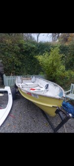

Removal of alluminum boat fiberglass top cap
Aug 9, 2021
58
I have an old 12ft alluminium boat with a fiberglass top cap (I think it's called a top cap) I was just wondering if anyone knows how to remove it and if I would be able to remove it without destroying it as such so that if I wanted I could put it back on. Pictures belowScreenshot_20221016-210738_Gallery.jpg
51,399
pull the rub strip rubber
remove all 4 million screws
use a putty knife to separate the sealer between the cap and hull
lift (I used ratchet straps to the ceiling rafters of the garage)

Do you recommend removing it for this boat or would it be better to keep it on, thanks for the reply appreciate it
51,399
if you have to get under it to restore the foam and transom, yes.
however that cap is adding structure to your hull. if you plan on removing it for the sake of more room, you have to add some structure back to the hull.

And what would be the best way to add structure with the top cap gone?
51,399
depends on what you want.
however based on your posts, you want a simple utility boat. in that case, would be cheaper and faster to sell what you have and buy what you want.
some aluminum utility boat gunwale stucture is a T-bar gunwale, some is a formed channel.

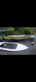

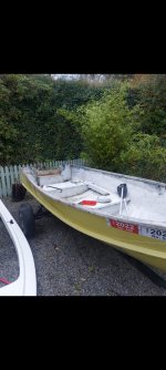

Aug 9, 2021
58
Well, I've went and taken the cap off. The hull and gunwhale seem to be strong enough without the cap attached ...

Nice. I was wondering if the top rail was there. Looks like they simply added to glass top to an existing platform.
