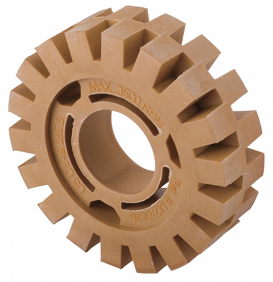

I'm about to receive a decal remover my decals are 1988 so I will try and let you know :) ABN Decal Eraser Wheel Pinstripe Removal Kit was my choice , will let you know

Not a majic eraser, a decal eraser is a rubber compound wheel on a spindle, that goes in a drill and friction rubs decals off.

that's what got coming I tried heat gun but moving a inch per hour I was like ohh hell naw, so I'm going to try this lol the outer layer has like 11 stripes built on top of each other probably went on as one stripe but comes off 11 pieces lol

worked like a charm but looks like one wheel per side for big graphics took about 20 minutes and they were history!

The decal remover worked great. I was able to get off the decals. I used a heat gun to warm the decals and it seems to come off much easier when applying the decal remover to it. I also used a steel wool pad to clean up any residue that was left from the decals. I'll clean up the remainder of the boat with the steel wool pad and pressure washer. Yes, the remaining color around the decal is paint with aluminum. I'll require a smooth finish to apply the boat wrap. I think I'll purchase the following boat wrap to ensure any blemishes underneath the wrap are not noticeable. Any wrap that is glossy will most likely easily show blemishes: https://www.amazon.ca/Carbon-VViViD...1-5&keywords=5ft+x+60ft+300sq+ft+Cast+VViViD8
